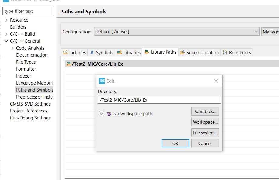

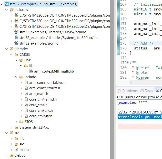

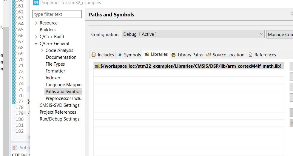

I have a problem when I add ARM DSP library, the following error appears:
c:\st\stm32cubeide_1.0.0\stm32cubeide\plugins\com.st.stm32cube.ide.mcu.externaltools.gnu-tools-for-stm32.7-2018-q2-update.win32_1.0.0.201904181610\tools\arm-none-eabi\bin\ld.exe: cannot find -lC:/IoT/../L59_stm32_examples/Libraries/CMSIS/DSP/lib/arm_cortexM4lf_math.lib
so I tried everything I know but not solved, I add the library to the project, change the name change extinction from.a to .lib, and here is some photo from my project.
Please help and thanks in advance!

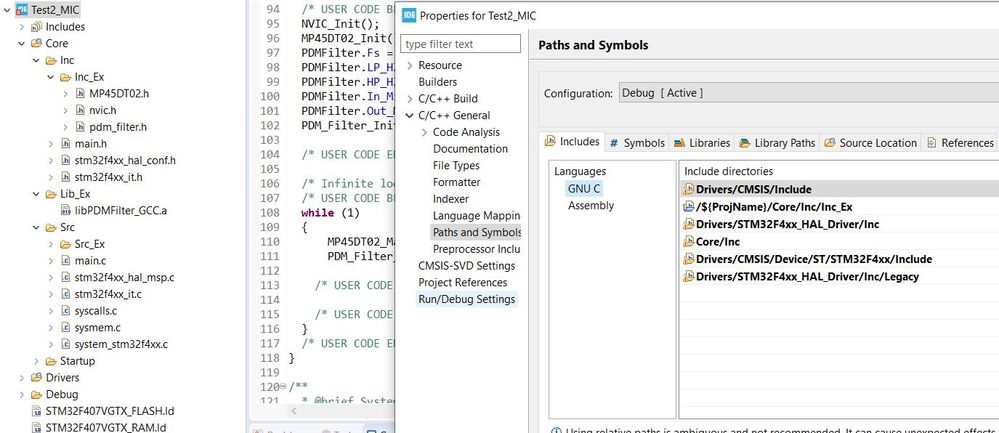

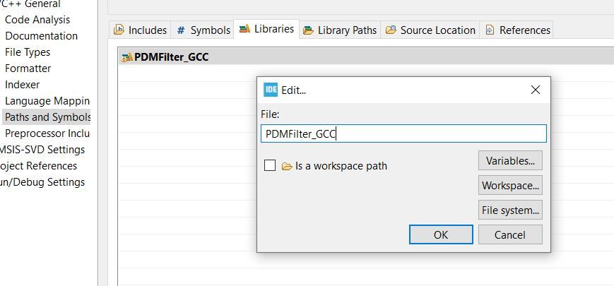

First thank you very much..
I try this but still don't work..I don't know what I must do to make it work!
2020-05-16 1:24 AM
Hi Rashad, I think you have to remove the "/$(ProjectName)/" in the Includes path and leave it as "Core/Inc/Inc_Ex".
My solution was for the DSP library. I've never used this other PDMFilter library. SonI don't know if I would be able to help you much more.
2020-05-16 8:53 AM
Thanks a lot man �?lvaro Frutos I know you try hard to help me but not always things go right...Thanks
I know your solution is for the DSP library but I have the same problem in the two libraries.
Now I use pcm2pdm library and it's work fine..just discovering new parameter..even that PDMFilter library has more options such as LPF ..but It works fine for now.
