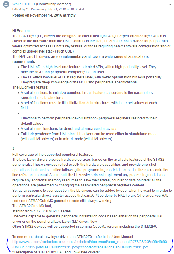

I'm searching a starting point to program for a blue pill or other STM32 M3 or M4 architecture under STM32CubeIDE, but not using HAL, just plain C. Where do I find the appropriate libraries, headers and documentation?

You might have misunderstood my level of knowledge. First off, I know C for decades. I know that HAL is a layer, not a language. I already programmed the devices in assembler. So I already dealt quite a lot with the registers etc. I just don't like HAL.
My question only aims at where I can find the documentation for the C-API, be it LL. And how do I switch off HAL when creating a C/C++ Project under STM32CubeIDE?
OTOH, even if I would be using HAL, where do I find the documentation, the #defines and available functions etc.?
you didnt clicked in any of the links i sent didnt you XD.
basically you go to your specific chip reference manual
as they are just libraries, delete the corresponding ....hal.....h include0693W00000WHZxPQAX.png, or if they are still giving you trouble remove the folder from the project path.

@Javier Muñoz​ : sorry, didn't recognize there were embedded links. Did you edit your message? Since I didn't see the links in the first place. And thanks. Found the link to the HAL and LL driver manual.
