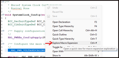

I am using STM32CubeIDE (eclipse) and was wondering if it is possible to get the constant calculated value of a macro.
For example
#define A 1
#define B 2
#define R A+B   // R is now 3
#if R > 2
  #warning R is greater
#else
  #warning R is less 2
#endif
I can only see 1+2 in the macroexpansion. But clearly the IDE has calculated the value and can evaluate the #if ... #else and gray out the unused part. So how can i access this calculated value?

A macro does not have a stored numeric value, it only performs text substitution. The preprocessor can evaluate the expression in #if, which is why the IDE can determine the active branch, but that result is not directly accessible as a macro value.
If you need a real compile-time constant, use an enum or a const instead.
That's to be expected; that's what macro expansion does - it is purely text substitution.

Thanks but that only gives me the text and not the calculated value.
> A macro does not have a stored numeric value, it only performs text substitution. The preprocessor can evaluate the expression in #if, ...
And in addition to that, the preprocessor is a different "entity" than the C/C++ compiler, and uses different datatypes and ranges than the compiler. The result of preprocessor "calculations" might not be what you expect.
Thus I would definitely second that.

That still just shows the macro expansion - it doesn't evaluate the result of the expression after expansion.
@Nickelgrass I think you're just going to have to do the evaluation manually.
Or write some test code that will do it for you ...

Note that this comment is incorrect:
R is not 3.
R just expands to A+B
R does not have the numerical value 3
And, for safety, it should be
#define R (A+B)
