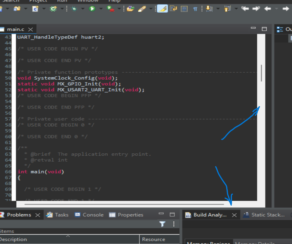

It's been two years since version 1.14.1 (everything was fine there) – is it really that hard to remove these white scrollbars? It's impossible to use STM32CubeIDE...

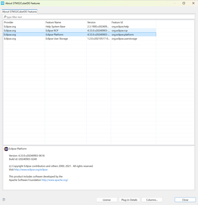

At present, STM32CubeIDE 2.0.0 is built on Eclipse Platform version 4.33.0.v20240903-0618
The migration to a newer Eclipse version within STM32CubeIDE is planned for next year.
The behavior reported by @bobval  is described in this LINK
Additionally, the issue where Eclipse does not fully switch to "Dark Theme/Mode" is reported in the following LINK

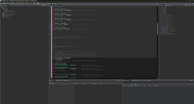

I tested this behavior using STM32CubeIDE 2.0.0 and did not encounter any white scrollbars.
Could you please let me know which operating system you are using?

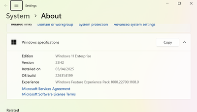

Windows 11 25h2 , (On Windows 10, everything was fine.)
Hello @bobval
I performed the test on a Windows 11 machine and did not encounter this issue, which suggests that the problem may be specific to your environment.

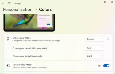

1- Go to Settings > Personalization > Colors
2- Set "Choose your default app mode" to Dark.
"Set "Choose your default app mode" to Dark." -
I don't use the dark theme in Windows itself; I don't need it. While I was on Windows 10, everything worked fine without it.

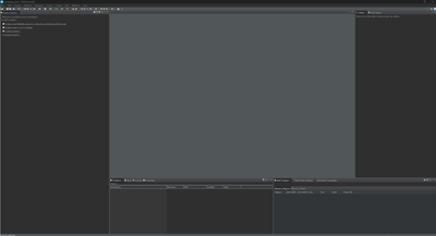

For those were darkmode currently works correctly:
Go to `Preferences -> General -> Appearance`. There, set `Color and font theme` to something different than the default and change it back. Do you still not have these big white scroll bars? For me they appeared after I changed some settings in the appearance dialog.

Hello @bobval
As shown in my screenshot above , I am unable to reproduce this behavior on my end, which suggests that it is not systematic.
