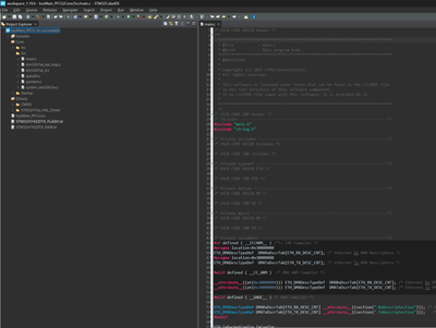

I made a new project by importing an .ioc file.
When the project opened/created, I was introduced into pinout view of the MCU.
While I was there, the software (Stm32CubeIDE) got updated, asked me to restart to finish the update.
I accept the restart.
After the restart, I open my project

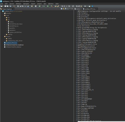

If I double click my .ioc file, it just opens the file with txt editor:
I do not know how to enter pinout view again.
Obviously, I have tried looking on all the tabs/options, right clicking everywhere. It should be something easy, I just missed it.

CubeIDE v2.0.0 no longer has the CubeMX functionality integrated:
https://community.st.com/t5/stm32cubeide-mcus/cubeide-2-0-does-not-open-ioc-files/m-p/857301/highlight/true#M39483
You will have to use the separate, standalone CubeMX application:
https://www.st.com/en/development-tools/stm32cubemx.html

On the STM32CubIDE V2.0.0, the STM32CubeMX plug-in has been removed. So, the .ioc file need to be opened by STM32CubeMX.
Best Regards.
