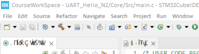

STM32CubeIDE 1.9.0. Inside Window tab title text broken.

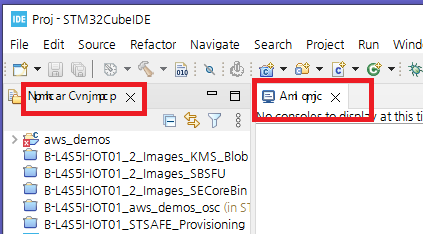

I am using Windows 10, and I am currently working in Korea, so the Windows display language is English and the App display language set is Korean.
I think this happened after I recently updated Windows 10.
I deleted STM32CubeIDE and reinstalled it with version 1.9.0, but this did not solve the problem.
This problem seems to be caused by a codepage conflict in Windows, so I solved it by setting both the Windows display language and App display language to 'Korean'.
However, for all other software such as ArduinoIDE, there is no problem at all even if the Windows display language and the application display language are different.
I still want to use English as the Windows display language.
I hope STM32CubeIDE doesn't have any problems like other software.
