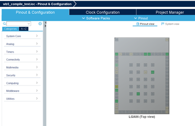

When I create an STM32CubeIDE project with STM32WB5MMGH6TR, I see the correct pins and everything.
Just to test the flash memory space, I added a couple of two dimensional arrays until I got error that flash is full.
This is the maximum amount of flash that I can load (so about half a Mbyte, not the 1-Mbyte that was said in datasheet.
If I add a 128x128 image to the memory too, I get
c:\st\stm32cubeide_1.10.1\stm32cubeide\plugins\com.st.stm32cube.ide.mcu.externaltools.gnu-tools-for-stm32.10.3-2021.10.win32_1.0.0.202111181127\tools\arm-none-eabi\bin\ld.exe: wb5_compile_test.elf section `.rodata' will not fit in region `FLASH'
c:\st\stm32cubeide_1.10.1\stm32cubeide\plugins\com.st.stm32cube.ide.mcu.externaltools.gnu-tools-for-stm32.10.3-2021.10.win32_1.0.0.202111181127\tools\arm-none-eabi\bin\ld.exe: region `FLASH' overflowed by 12356 bytes"
So the questions.
1. Is the 1-Mbyte flash advertised in datasheet the total of both the M0 and M4 processors?
If so, how do I know which processor I am programming right now? I assume it's the M4 one since the
M0 is for radio and security according to datasheet.
2. How do I get access to the other half Mbyte? And how do I specifically program the other processor?
3. If my assumption of splitted flash is correct, is it the same with RAM? Any way to know how much RAM each controller has?
