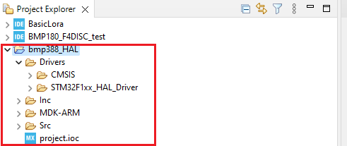

Hi. Im using STM32F103C8T6 to interface BMP388 pressure sensor. I downloaded a example project file. When i trying to debug it using ST-LINK I'm getting unable to launch error.
In debug configuration window im getting 'Project file does not exist' error.
How can i debug this project?
Here is my project explorer window

It looks like the folder has been opened as just a folder.

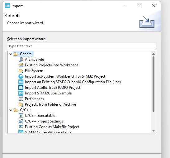

Maybe try the import wizard (file>import) on that folder.
which of these? i tried all but result is same
