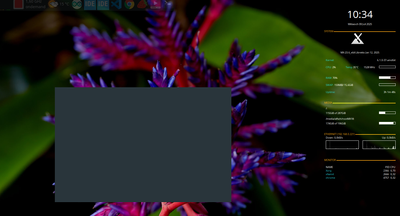

Hi @Ghofrane GSOURI ,
so i deleted cache, start IDE ...crash...now it looks like this:
grey splash screen  :)

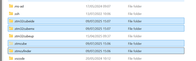

Hello @AScha.3
first close all ST applications and clean your environment by deleting the folders .stm32cufinder, .stm32cubemx, and .stm32cubeide from your PC. Then, relaunch the IDE and use the Help → Check for Updates option to update the software and packages. If problems continue, uninstall STM32CubeIDE completely and reinstall the latest version to ensure a clean and stable setup.

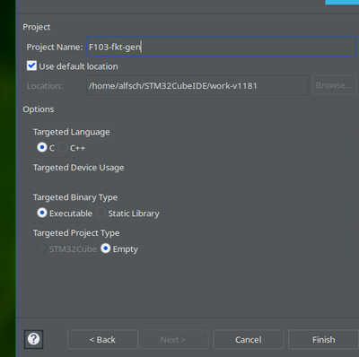

..with new workspace :
Cube cannot select..

Hello @AScha.3
Please try to
-Close STM32CubeIDE
-Delete all those files from your PC: .stm32cufinder, .stm32cubemx, .stm32cubeide and .stm32cube
then restart the STM32CubeIDE and retest again.
great !  One of these is the "bad" .
Generates Cube project again.
Thanks for your effort. :)
