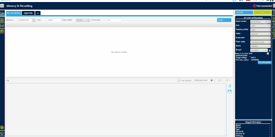

Hi
When I using STM32CubeProgrammer 2.22 GUI and try to control option byte, the page can't display.
while CLI can read option bypte.
Hi @Zhou JianQiang,
Thanks for highlighting this,
Issue confirmed and will be fixed in the next release (Internal tracking number: CDM0062754). In the meantime, could you try replacing the attached file in "\STM32CubeProgrammer\Data_Base"
Let me know if this works.

Hi @Aziz BRIGUI :
Thanks, it works!
