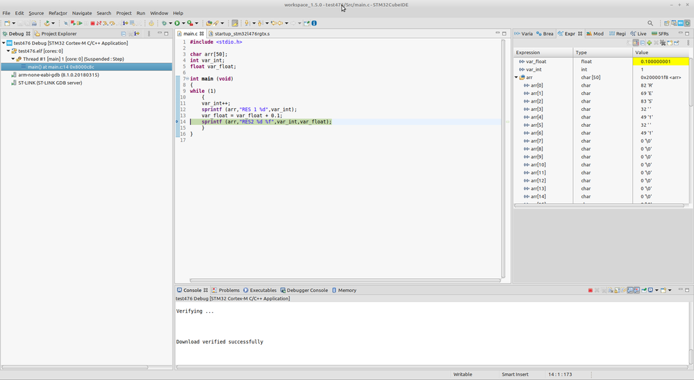

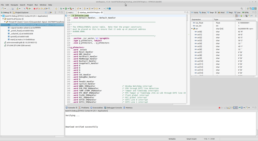

on STM32L476 nucleo kit, with STM32CubeIDE (Version: 1.5.0 Build: 8698_20201117_1050 (UTC)), I'm using debugger, stepping the code and observing variables in expression window, however the code always fails at second sprintf call (the one with float variable). Before trying to execute second sprintf call I can see proper output from first sprintf call, as well as float variable with proper value
but after second sprintf call I find the MCU executing endless loop after fault. The second sprintf managed to print output up to the floating point part.

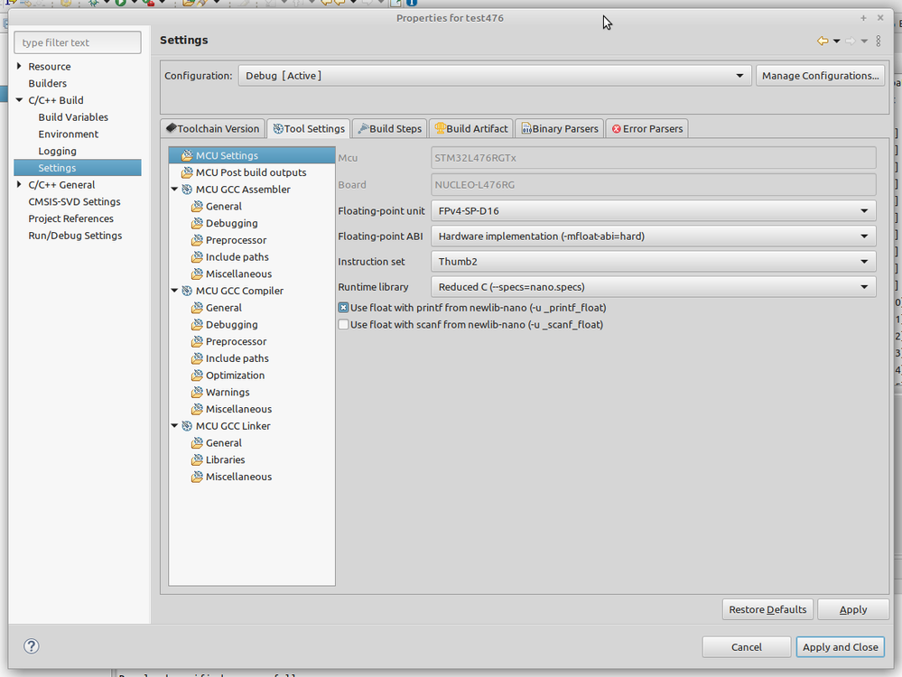

I started fresh project for this, didn't modify linker file nor any project settings, with exception of ticking "Use float with with printf from newlib-nano"
I suppose hard fault from sprintf is not desired outcome, but I can't find any obvious way to fix this.

I tried the same source, with the same project setup modification (single checkbox to use float functions) on STM32F091 nucleo kit, where it works as I expect (second printf doesn't crash and prints desired output to char array).
Perhaps I'm overlooking something very obvious, but I can't see where the problem is.

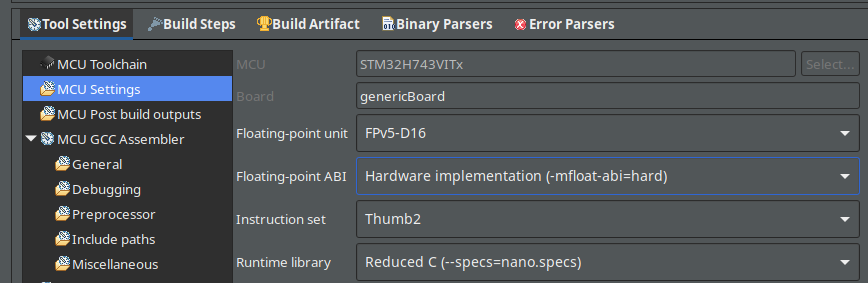

I am facing a similar problem. How did you enable the FPU in project?
‎2023-05-29 6:57 AM - edited ‎2023-11-20 9:16 AM
in project setting...can choose hardware FPU, if possible on target cpu...

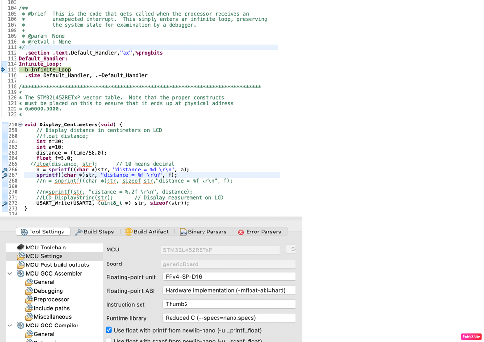

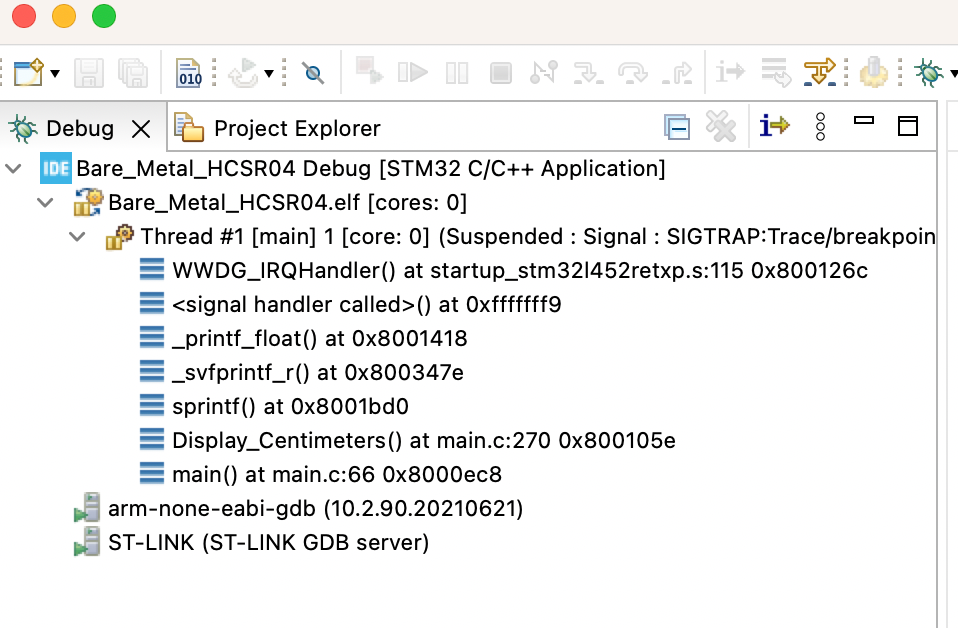

Although all settings are correct, sprintf doesn't work with floating point number only. Although it works on stm32cube, it doesn't work on bare-metal program. It loops endlessly in the Default_Handler function. I'm about to go crazy. what else can i do?
‎2023-06-01 4:55 AM
Are you sure this is consequence of a fault? It may be e.g. also incorrectly set interrupt vector table.
At any case, don't hijack others' thread. Instead, start your own, stating your hardware, used software, expected and observed behaviour. If you feel this thread is relevant to your problem, give a link to it.

How can i disable WWDG_IRQHandler?
