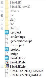

DCagi.1
Hi @Cyril FENARD​
These are the files before compiling the SIMULINK model:0693W000000U7XMQA0.jpg
These are the files after:
As you can see, a ".project" is generated, which is the one I open within STM32CubeIDE.
Not sure what you mean by "check the properties of BlinkLED items".
Is this something to modify within the BUILD configuration in SIMULINK? If so, how?
Thanks a lot

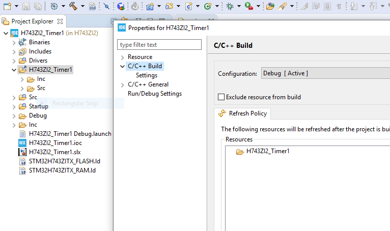

Cyril FENARD
Hi @DCagi.1​ ,
I share an example of build properties under the STM32CubeIDE view:
Regards,
Cyril

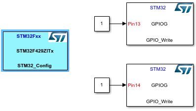

Which part of the code should I check? Which file actually contains "the logic" modelled in Simulink?
This is the Simulink model, and I have attached the Simulink build log file (.txt):0693W000000UVLZQA4.jpg
Thanks everyone.

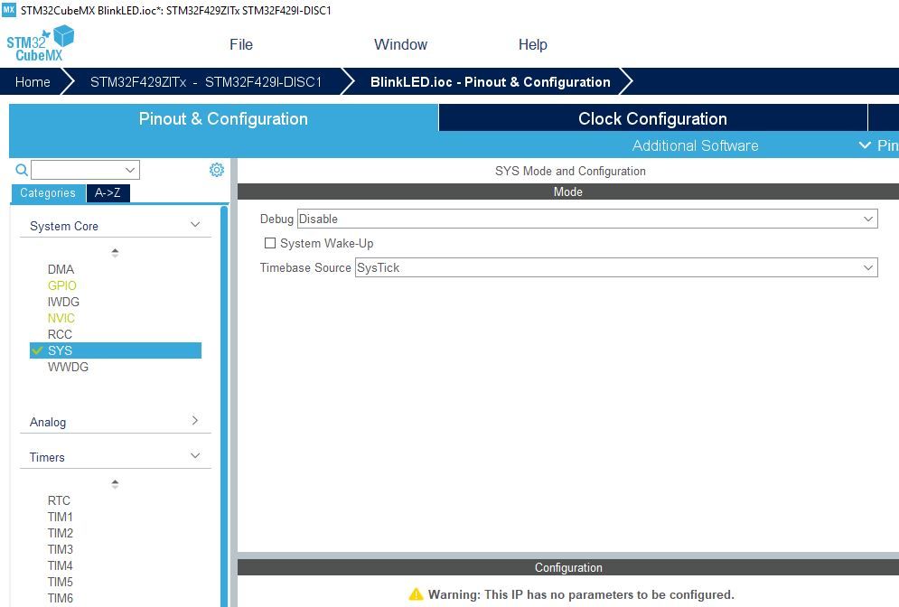

It seems, it never gets to the "BlinkLED_step ()" function, since this variable is always 1: remainAutoReloadTimerLoopVal_S == 1
Could it be related to any configuration of the clock within Stm32CubeMx (.ioc file)?
With the "System Core", selecting the "SYS", the timebase source is set to "SysTick":
Any ideas?
