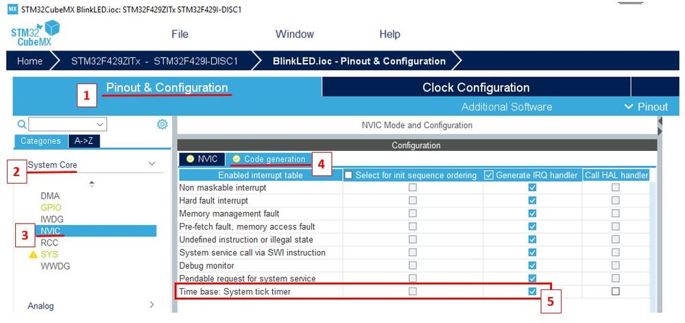

  2. STM32CubeMX: generate the .ioc file for the right board/MCU in order to blink the green LED:
    1. Give it the name "BlinkLED"
    2. PG13 as GPIO_Output and with a name "GreenLED"
    3. Select: ProjectManager\Project\Toolchain\IDE = STM32CubeIDE
    4. Select: Pinout&Configuration\SystemCore\NVIC\CodeGeneration\TimeBase:SystemTickTimer -> TICK ON "Generate IRQ handler"

Hi @Cyril FENARD​
I can not find such a file.
I have packed everything into a .zip
Doing a search in all files (Using Notepad++), the function SysTick_Handler() does not appear anywhere...
Thanks a lot

Hi @DCagi.1​ ,
"Generate IRQ handler" is not set for "Time base Sys tick timer" in your STM32CubeMX project (BlinkLED.ioc).
Regards.
Cyril
DCagi.1
Hi @Cyril FENARD​
Eureka! Now it is up a running, thanks a lot for your valuable help. I will try to make some comments in the 1st post, for others to benefit from it.
