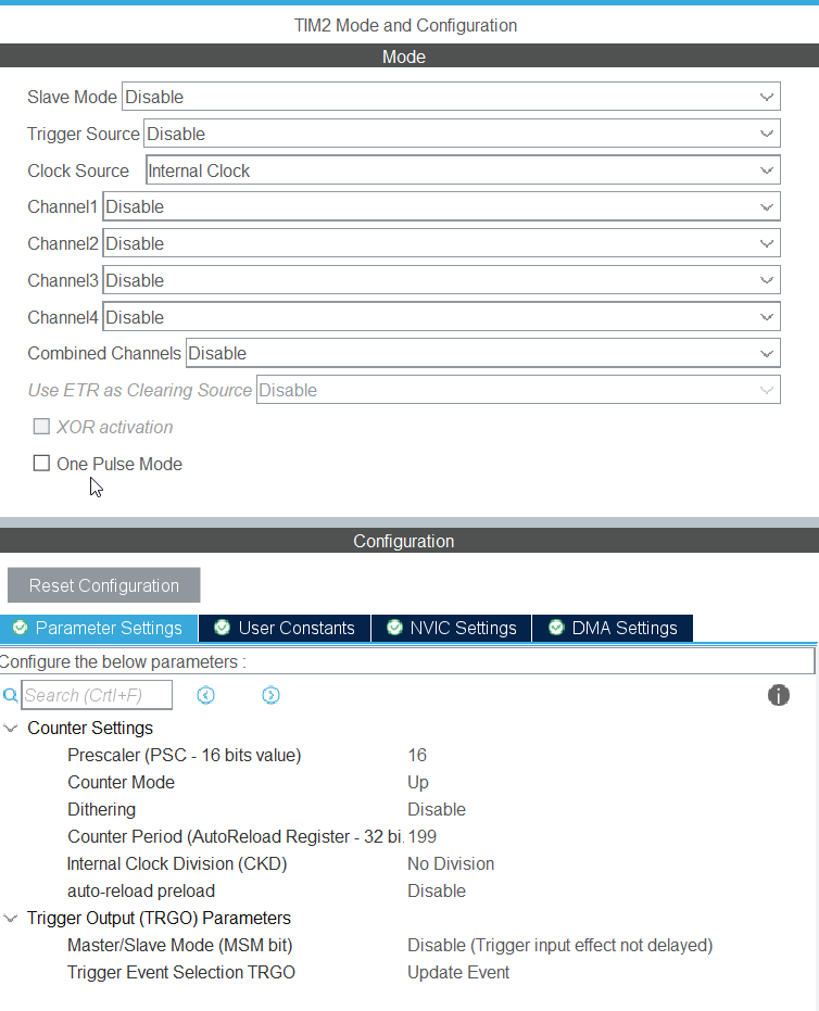

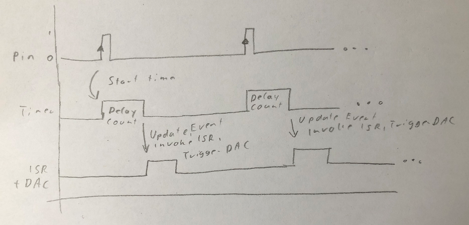

how do I have to setup the timer-2 so it create an one-shot delay on every rising edge (could also be falling, does not matter).
This timing diagram indicates what I like to do, so I get an output-Event for the DAC and callback for an ISR(optional):
Thanks a lot.
Best Regards, Seppel

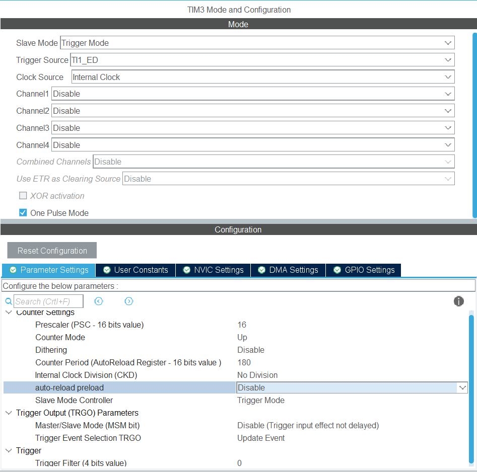

2022-10-20 1:45 PM
solved, however I still struggle with the ARR(AutoReload) and why it needs to be disabled. Maybe somone can send me a good guide on timers (please no ST-documentation like ST-Timer-Cookbook).
Thanks a lot.
