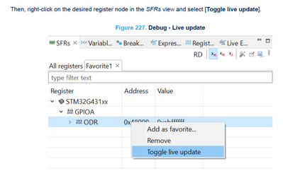

hi all
in stm32cubeide user guide on page "160" said that: "It is possible to use the SFRs view while the target is running when using the ST-LINK GDB server. However, the [Live expression] option in the debug configuration must be enabled in this case."
but :
with considering all things that the user guide said, just "live expression" works when the target is running, and for updating SFRs we should debug or (suspend and resume) program
, while in Keil this option works, and SFRs update when the program in running mode.

Hi Ali,
There is one way to make it update timely. See the introduction below.
BR,
JN
