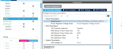

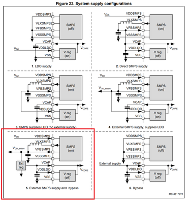

All STM32H7xx devices are not the same. Their ST boards too.
What board are you using. NUCLEO? DISCO? Custom?
Some boards are configured in SMPS others are in LDO.
So you need to check what power config is set in the board by hardware and set accordingly the power config by software.
But before that you need to recover the board from the power deadlock state: How can I recover my STM32H7/STM32H7RS board after facing a power configuration deadlock?

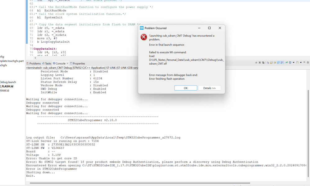

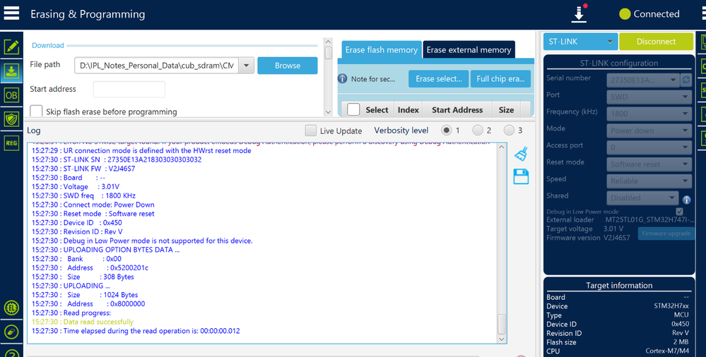

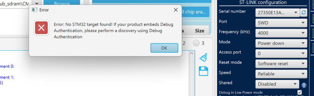

  • Does CubeProgrammer work OK?- Yes using the cube programmer I am able to Flash code but have to set frequency to 1800, while other board works on 4000 (able to debug it)
  • What, exactly, happens when you try to debug? Show error messages, etc ... Have attached the images from cubeprogrammer for both frequencies. on 4000 its not getting detected but getting connected at 1800 as in images

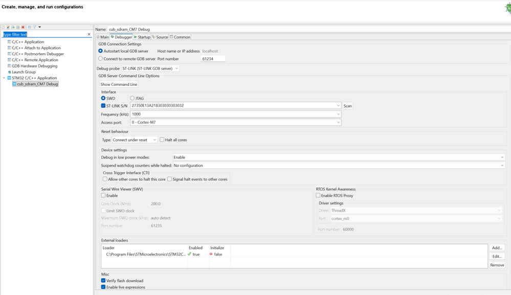

  • Changed the setting in STM CubeIDE in Debug Config set freq to Auto got above.

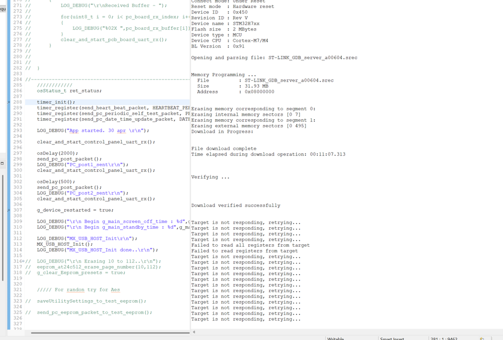

This is what happening after the code is flashed and after few seconds getting "Target is not responding, retrying"
1- Please provide details about the power config of your custom board? LDO? SMPS? what you have configured by software?

Have you tried connecting under hardware reset?
Have you tried using the System Bootloader?

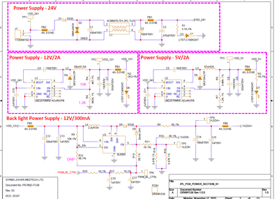

Hello @mƎALLEm
Here is the details
Shiv09_0-1779273998720.pngThough the settings and configuration is notchanged.
Yes both the boards are identical, and same.
