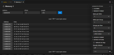

I am debugging an STM32H563ZI with the following environment:
  • OS: Ubuntu 20.04 LTS
  • STM32CubeMX: 6.15.0
  • Visual Studio Code: 1.102.3
    • Extensions:
      • STM32Cube Bundles Manager: 0.23.3
      • STM32Cube Debug STLink GDB Server: 0.10.1
  • Board: NUCLEO-H563ZI
In this setup, after launching the debugger, I cannot find a way to inspect the values in Flash, RAM, or the registers of the Cortex-M33 peripherals.
Regarding memory, I tried installing the "MemoryView" extension, but I am still unable to view the values. Are there any alternative extensions with similar functionality?
Regarding peripheral debugging, while I can see registers for peripherals like GPIO and ADC on STM32CUBE REGISTERS TREE, I cannot find the Cortex-M core peripherals like the SCB (System Control Block) and NVIC (Nested Vectored Interrupt Controller) . How can I view these?

Hi Fumihiko,
Unfortunately, it is not possible to view the Cortex-M registers yet, but this feature is planned in our roadmap.
Regarding the memory view, the STM32Cube for Visual Studio Code pack already includes a memory viewer, the one from CDT Cloud called Memory Inspector.
During a debug session, you can open the Memory Inspector via the Command Palette (Menu: View -> Command Palette...).
Then, filter the Command Palette by typing Memory: Show Memory Inspector.

Hi Florent,
OK, I hope the feature will be released in the near future.
After installing "Memory Inspector", I was able to check memory values during the debug session.
Thank you for your support.
