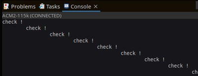

i just tried on old "blue pill" board, F103 cpu:
char chpfrt[]= "check ! \n";
/* USER CODE END PV */
//in main loop:
  /* USER CODE BEGIN WHILE */
  while (1)
	  CDC_Transmit_FS((uint8_t *)chpfrt , sizeof(chpfrt));
	  HAL_Delay(1500);
You are sure, you have a usb data cable connected on the usb user port of disco board ?
Get enumeration (ding-dong..) on cable plug in ? What device manager shows ?

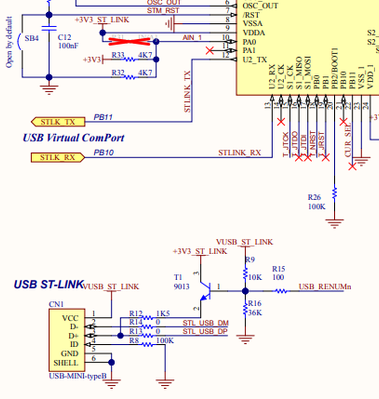

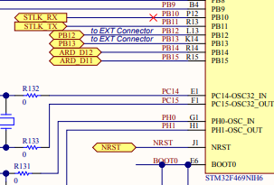

So from pic : you use F469-disco , connected to USB -> st-linkV2 onboard .
This connects to PB10/11 on F469 :
So you have not connected to user-USB , but to st-link VCP (on uart rx/tx ).
To send on this connection, you have to look : which uart you connect to PB10/11 and set its speed to 115k/8n/1 .
(probly : usart3 )
(If using Cube -> start with "board xxx" , it will pre-set the serial , just look, to check it.)
Then send with:
 HAL_UART_Transmit(&huart3, (uint8_t *)&ch, 1, 0xFF);
