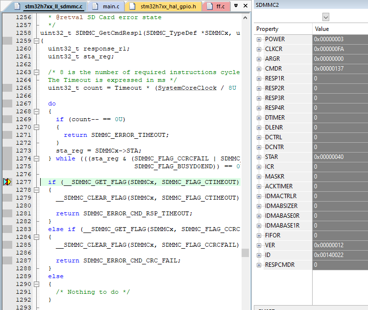

XLin.2
I am still having problems with my custom board, which is Stm32H753, SD in 1 bit mode, Input clock 200Mhz, SDMMC2 interface as SD, with clock divide by (3+1), no transceiver. It always fail in SD_PowerON(). I traced it to SDMMC_CmdAppCommand()
_legacyfs_online_stmicro_images_0693W00000bj8snQAA.png, where it sends 0x37 and expects the same comes back from RESPCMDR registers. There was no timeout or CRC errors, just the RESPCMDR was 0.
I have attached a screen capture. I am not familiar with SD cards, please help.
The pins for SD are PD6(CLK), PD7(CMD), PB14(D0), all are high speed AF, with internal pull ups. I am using CubeMX 6.8 with H7 package 1.11.0.

Still no luck yet. A question I have is about pins: Looking at the schematics of my board, it is in 1 bit SD mode. D1-D3 on the card slot side are left floating, should they be pulled? And for CLK/CMD/D0 are internal pullup (40Koms) enough?
AScha.3
first -
  • use 1 bit mode
  • set pullups on all lines
  • set pin/port speed at medium or meduim/high (try)
  • use clock 100M div 1 (50 MHz) ...or lower.
