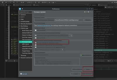

  4. If you deactivated the auto refresh function previously, you may wish to reactivate it for all your STM32Cube tools. Here is how to proceed:
  • STM32CubeIDE:
    Go to Window > Preferences > STM32Cube > Firmware Updater.
    Select your preferred auto-refresh option.
