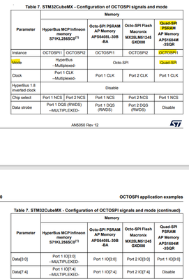

Hello I am using STM32H723ZGT6 mcu for my project and i am using external flash W25Q128JV but in my controller octospi is given and I want to use Quadspi to read\write data in external flash so how can I do it can anyone help me out if you need more details, let me know

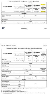

The OCTOSPI interface supports QuadSPI memories. Please look at FAQ: Does OctoSPI interface support QuadSPI memories?.
You can find in Getting started with Octo-SPI, Hexadeca-SPI, and XSPI interfaces on STM32 MCUs - Application note and precisely section "7.2 OCTOSPI configuration with STM32CubeMX" an example of Quad-SPI PSRAM memory connected to OCTOSPI interface.
