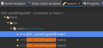

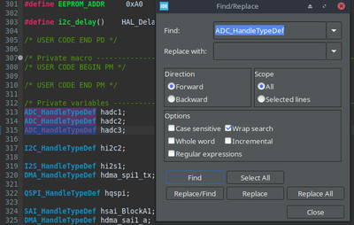

‎2023-07-24 2:33 AM
ad 1 . why not use "find.." from menu ?
or find in files to search on project..files ? right click -> Search text..

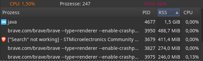

ad 2.
this is more a windows problem : use 1GB of 8GB shoud be nothing problematic. except for Win...
see: i run Linux (MX18 , 5y old) , on 8GB , AMD quadcore 3GHz;
the ide (java ...) use up 1,5GB here, the browser (49 windows open) about 2GB -> still > 3GB free. zero problem!
and mem use:
