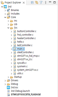

"main.c" is not visible.
2025-01-08 9:15 PM
This is the screen I want.
However, this is my actual screen.
I am sure I have chosen the board correctly.
Solved! Go to Solution.

Hello @hjjang ,
Let me thank you for posting and welcome to the ST Community.
It seems that the STM32 firmware is not installed. Therefore, I recommend that you set the Network Connection and log to your ST account before generating the code.
I suggest that you take a look at UM2609 section 1.2.3 STM32CubeIDE user authentication.
Thanks.
Mahmoud

You're probably not importing the project correctly or there are some project configurations missing. What does the project tree look like in File Explorer?

2025-01-08 10:16 PM
Is this correct?
2025-01-08 10:36 PM
You have no source files so that is why nothing shows in the project tree

2025-01-08 10:41 PM
I know that main.c is automatically generated when I select the MCU board.
It is not generated even when I connect the ST-Link.
2025-01-08 11:33 PM
You need to describe how you're creating a project and which uC
TimerCallback tutorial! | UART and DMA Idle tutorial!
If you find my solution useful, please click the Accept as Solution so others see the solution.

2025-02-16 6:44 PM
I had to install the software pack as shown in the picture.
Thank you very much.
