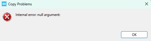

"Internal error: null argument" trying to copy from example selector
nala_ed70
I find one example that helps me at the "example selector" . I can open, edit, and run it. if I want to copy it, I have this error. Does anyone know the solution? It creates the project, but the subfolders are not fully copied, like 80% are not there.

Hello @nala_ed70
Could you please try these steps:
- Copy the project directory (so that it is on same directory level, to avoid relative issues)
- Delete all eclipse dotted sub directories. Keep only .project and .cproject dot files.
- Edit the .project file and change only the project name there.
- Import the new project into CubeIDE and REFRESH.
BR, Souhaib
