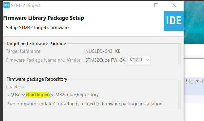

Every time i'm trying to open a new project in IDE, after choosing the board and a name for the project i get this "Create minimal project failure: cannot read template source" error message
Is there any solution?
screenshot is attached
Thanks in advance,
Ehud

Hi @EKupe.1
Which STM32CubeIDE version do you use?

2020-04-29 9:20 PM
the one that available at the site (1.3.0)
also i had checked for upgrades so now its 1.3.1
2020-04-29 9:32 PM
You have a space in your Windows username: ehud%20kuper.

2020-04-29 9:42 PM
Hi @EKupe.1
Try to change the space that's in your user name then tell me if it solve the issue.

2020-04-30 7:25 AM
Yep! It did solve the problem..thank you all very much!
