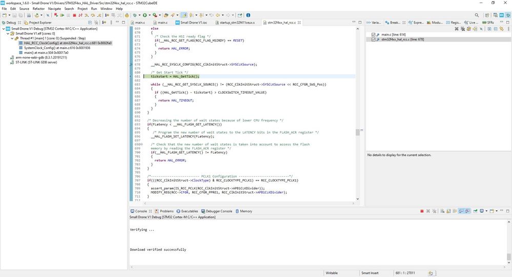

Ive now stepped through it to see where it goes wrong and it fails at this part of the code:

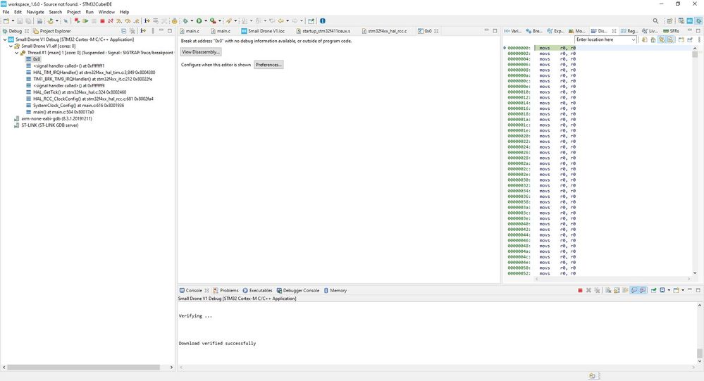

If I step through the code one more step then it comes up with this:
The disassembly is shown on the right where as far as I can see its just the movs r0, r0 command continuously and it just crashes after this.

FLASH and ART cache tend to be the critical path, the former can be tuned with extra wait states, the later has limitations on the prefetch path into the core.

This is not result of one step, this is running through lockup (0xFFFF'FFF9) and then surprisingly some more.
Step-into not step-through, and step in the disasm view to see where it goes astray.

If I step into the asm like I did in the screenshot above it gets to that first line and then if I step again the microcontroller crashes.

From your second screenshot, it's inside a second interrupt handler. Examine the VECTACTIVE bits in SCB->ICSR to see what interrupt it's in.
Surely you can step in disasm since the reset vector. Find out where that leads to.
