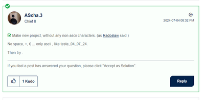

2024-07-04 3:10 PM - edited 2024-07-04 3:15 PM
It's not showing ...
It should get a tick and green background - like this:
