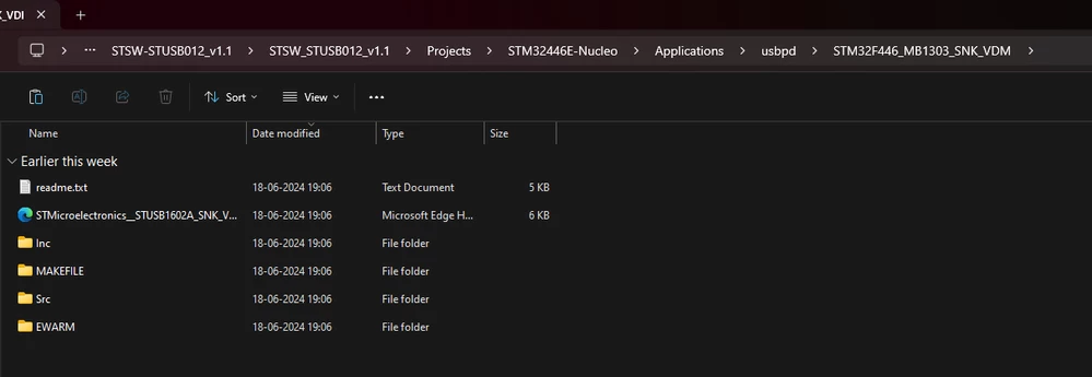

Hello, I'm new to STM nucleo boards. Got my hands on the p-nucleo-usb002 usb type c evaluation board. I tried to import the demo projects to cubeIDE and it doesnt seem to build. I'm missing out something. Please help! The project files are as in the screenshot below.
Thanks,

    The software package STSW-STUSB012 is obsolete, there is no longer any support for it. When the software package was still active, it could only be compiled with IAR. An import of IAR projects is only possible manually, but is probably not useful for this project.
    I'm very sorry, but I can't give you a more pleasant answer.
