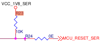

Hi all,
I have a similar type of issue I am using the stm32G0 series controller in which NRST pin voltage is dropping from 1.8 volts to 1.3 volts(ideally I guess it should not drop).
I am doing two things
1) watchdog reset(iwdg)
2) external reset on
after doing MCU powering on and I tried to generate the watchdog reset in MCU. at that time MCU is properly reset
after that, I am doing the external reset. it is also working properly.but after doing this external reset and then I tired to generate the watchdog reset at that time below two things happening
1) NRST pin voltage is dropping from 1.8 volt to 1.3 volt(remain same if not giving any external reset again).
2) watchdog reset does not happen in MCU.
Hardware setup at NRST pin
can someone please help me out on this

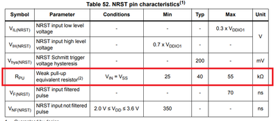

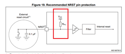

No need for an external pull up resistor as there is already an internal one.
From STM32G0 datasheet:
