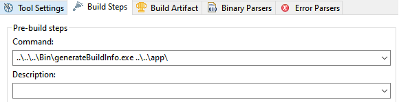

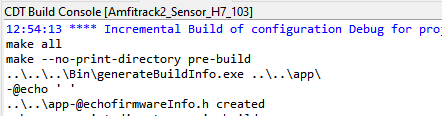

Im calling a exe file from CubeIde
it worked fine in true studio but now I get this -@echo in my file name.
can anyone tell me what Im doing wrong and how to avoid it

[Edited] Perharps the backslash? Try /
‎2021-02-09 4:59 AM
‎2021-02-09 5:05 AM
thanks, problem solved..
