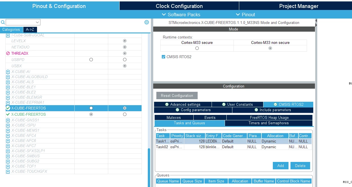

I am trying to implement FreeRtos in my application with TrustZone enabled.
I want to blink LED1 in task1 and LED2 in task2.
Neither of the task are running.
When I did the debugging in function xTaskCreate it's going into Infinite loop.
My configuration:
FreeRtos-Nonsecure
Stack-128
Heap4
LED1-Nonsecure
LED2-NonSecure
I have attached my configuration and piece of code w.r.t task.
I request anyone to help me resolve this issue .

    FreeRtos-Nonsecure
    LED1-Nonsecure
    LED2-NonSecure
    I'm not Security feature expert by why you are enabling TrustZone while your application is non-secure?
    And if you disable TrustZone are you facing the same issue?
    PS: next time please use </> button to insert your code.
    Thanks.
    Kendall7Author
    April 1, 2024
    Thank you for replying to my post.
    I am not facing this issue when trustZone is disabled.I am able to run FreeRtos without trustZone.
    I am enabling TrustZone in non-secure because I want my product to be UL certified.I want two partition one for critical and non-critical ,Since trustzone enabling gives me two Independent hex files I am trying to run freeRtos in Non-secure region.
