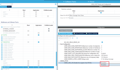

Hello:
  I wasn't able to enable support for RTOS in USB_HOST menu in CubeMX_6.14.0 for STM32H7R3I8Kx. There is only "Disabled"
  The version of STM32Cube MCU Package for STM32H7RS Series is 1.2.0

Hello @miku
An internal ticket (211979) is submitted to dedicated team to fix this issue.
Manually setting #define USBH_USE_OS 1U in the usbh_conf.h file should resolve the issue.
