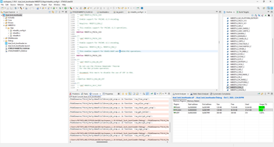

I want to use the rsa feature of mbedtls but when I uncomment #define MBEDTLS_RSA_C in the mbedtls_config file it is showing undefined reference to mbedtls_rsa_get_len, mbedtls_rsa_check_pub_priv, mbedtls_rsa_init, mbedtls_rsa_free and mbedtls_rsa_import_raw.

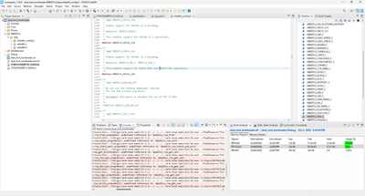

The rsa.c file was missing from the middleware package so I checked the mbedtls version in version.h file and downloaded the file from this link.
After that the build was successful.
