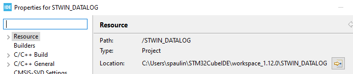

Wijeden,
Here is the path of the project but there is no spaces.
0693W00000aIaz0QAC.pngThanks.

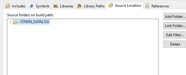

Wijeden RHIMI
Hi ,
Could you please check if the path is included in your source folders and that it isn't excluded from the build.
Project properties -> C/C++ General -> Paths and Symbols -> Source Location
Thanks ,
Wijeden,
It doesn't seem to be excluded from the build
0693W00000aIg66QAC.pngBut I did find out that the problem comes from the importation of the projects. When I tried to import the projects withouth checking the option "Copy projects into workspace" I didn't have the error anymore when building the projects.

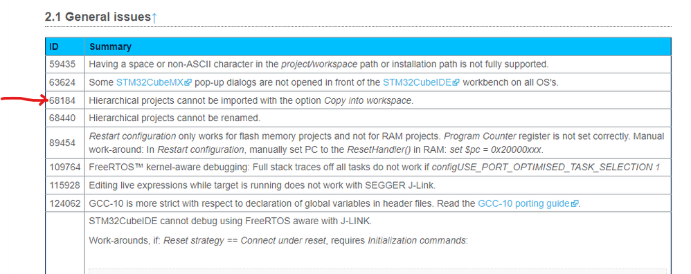

FYI, just saw this on the STM32VubeIDE wiki.
Wijeden RHIMI
Hello ,
Consult the Stm32CubeIDE User Guide chap 2.10 not 2.1 or simply search on import existing project.
You can import a project as written on STM32CubeIDE User Guide without check "copy into workspace" : Because this option breaks a lot of links. The example projects usually have paths outside of the specific example, so when you try to build it can't find all the paths and throws an error.
Don't hesitate to ask more questions !
