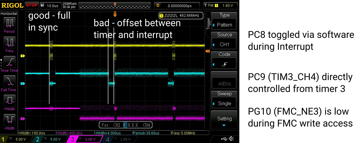

tested on nucleo stm32h723 board with STM32CubeIDE (only main.c is modified)
What does this example?
Timer3 triggers an interrupt every 40 microseconds. The interrupt toggles PC8 for ~2ms. Additionally we trigger a FMC data transfer every second for 10 seconds.
What is the Problem?
Every second during the FMC data transfer our interrupt handler is somehow delayed!
The global variable "ticks_end_max" contains the maximum number of the timer3 counter register just before the interrupt ends. This max counter value is ~2600, but only ~600 if FMC access commented out!

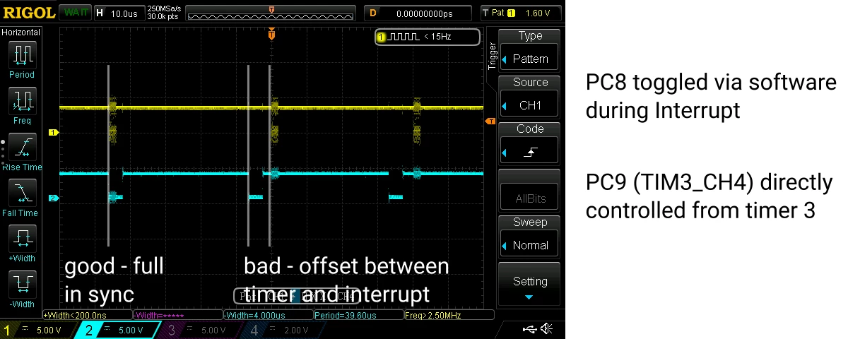

Using an oscilloscope on pins PC8 and PC9 is also possible. PC9 is configured as TIM3_CH4 and emits a 4us low pulse each cycle. PC8 is toggled for ~2us during interrupt. Trigger on rising edge of PC8 when PC9 is low.0693W00000aJiQAQA0.png

Please find attached a oscilloscope screenshot which also shows FMC_NE3. So The FMC is really executing the access. This was expected as we can talk to the externally connected IC without problems.
Interesting though, the FMC is still doing some data transfers after the timer interrupt was triggered. It seems like there is some kind of FIFO which has to be emptied before the timer interrupt is executed from internal memory.

The Cortex-M7 processor contains a 4-entry store buffer towards the AXI memory interface, which for Strongly-ordered memory area (and that's what you appear to have set in MPU for given FMC block) should behave as FIFO. From that scope waveform it's not quite clear if there are 4 writes to FMC between timer overflow and PC8 toggling or more. The ISR may be executing earlier, but the buffered writes may prevent the GPIO writes to be executed.

Sorry for the blurry screenshots. I've had a close look at the number of transfers done. It looks more like 5 or 6 transfers after the IRQ should be triggered, but beside that your explanation sounds very reasonable.
Additionally it looks indeed like you said: the interrupt might really be triggered immediately but has to wait for to access the GPIO.
So to explain our situation a bit more: Beside an SDRAM we have attached two different ICs via FMC to the STM32H7. The first one is really slow (575us access time). The second one - which we need to access from the interrupt - is quite fast. And yes, we used 'strongly-ordered" mode for both of them.
