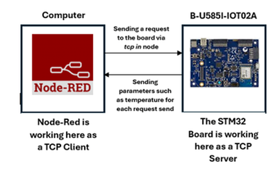

I’m currently working on a project involving an STM32 board (B-U585I-IOT02A). I would like to use this board as a TCP Server . Therefore, from the STM32CUBEIDE application, I had observed that there is an example project in which it is possible to render this board as a TCP Server (Nx_TCP_Echo_Server). However, my problem was that it only returns the value returned by the TCP Client. So, I wanted to modify this program so as to be able to retrieve the temperature parameters. So, I created a program based on an example (https://wiki.st.com/stm32mcu/wiki/STM32StepByStep:Step4_Sensors_usage). I wanted to combine these two programs to retrieve the temperature data.
To sum up, the diagram is as follows:

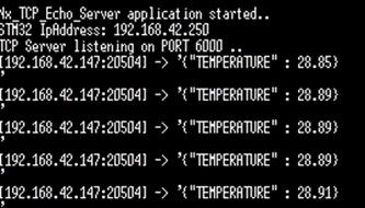

After activating the I2C module in the hal_conf.h file, I had no errors during debugging and was able to retrieve the temperature when sending a request from Node-Red. Nevertheless, this program has a number of flaws. The number of requests is limited, as you can see in the image below:
In the image above, I managed to send a total of five requests and collect the temperature, but unfortunately after the sixth request I lost communication with the STM32 board. I also noticed that the number of requests I could send was random. In fact, after resetting the board,  I am able to send more requests and sometimes I can send fewer.
On the application side, I'm using NetX Duo as well as ThreadX.
Would this have anything to do with memory? Would it be possible to increase the number of requests? If so, how could I do it?

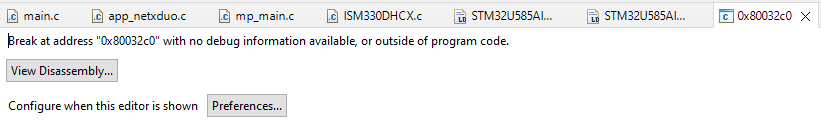

I don't really know if it's related or not, but I'm having a problem when I activate the debugger, I get some kind of window informing that it's trying to access an address and that it's outside the memory area :
