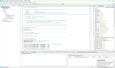

CubeMX Auto Code generation created STM32CubeIDE directory inside the project directory. I had to deleted it.
I got the project displayed normally. But it does not build project when clicking "Project -> Build Project"- Nothing happened.
I see that the Project has an "!" on the icon and on the IOC file. How did you import the project? Did you use Existing Project into Workspace?

"Did you use Existing Project into Workspace?" - Yes. I did.
The build project does not work.

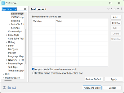

Also I found
Window → Properties → C/C++ Build
Environment Variables configuration in STM32CubeIDE appears empty (The files are exist in ST directory)
How to fix it?
