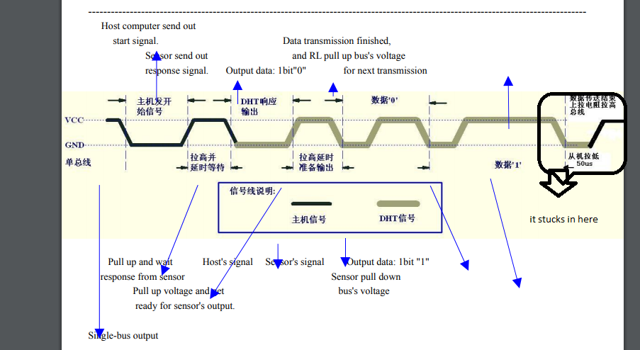

I'm trying to use DHT22(temperature and humidity sensor). I'm using STM32F030F4 Here is it's datasheet DHT22 Datasheet
In first few seconds. I can get values. But after a while it stucks in here:

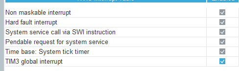

So i try to implement a timeout to prevent this. I start another timer (TIM14). And after 2 seconds i try pull the pin to low manually.
But as a result, variable 'k' (which is in the HAL_TIM_PeriodElapsedCallback function) never increments. So, again code stucks in same line. Could you help me, how can i implement a timeout to pull the pin low after a while

You'd need some secondary test so it actually leaves the loop at some point, Perhaps via an iteration count, or inspecting the TIM CNT to determine a maximum for elapsed time. ie 20 or 40 ms, whatever is reasonable for the sensor.
Also be aware that callbacks are operating in interrupt context, if they block they will prevent other interrupts from firing.

thank you. i added these two lines and now it works:
uint32_t ilk = TIM3->CNT;
while ((HAL_GPIO_ReadPin (GPIOA, GPIO_PIN_2 && (( TIM3->CNT - ilk) < 8000)  )));
