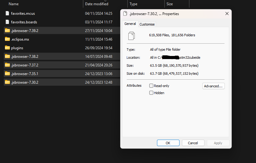

Hi all.  I have been witnessing a rapidly shrinking amount of free space on my C drive.  On a regular drive clean up of non-essential data, I can generally remove 1 Gigabyte or so of temporary files.  This however, does not account for the rapid depletion of available free space.
On further investigation, I looked into the 'Other' (Manage other large folders) section of the 'System -> Storage' properties of my Windows 11 C drive.  I was a little gob-smacked to discover that - between them - the ST related folders: stm32cubeide, stm32cubemx, STM32Cube and ST contain over 100Gb of data.
Obviously allowing for software packs and the various STM applications in daily use, I found a considerable amount of data was held in several .jxbrowser folders across more than one location.  For example, the .jxbrowser-7.38.2 folder inside the stm32cubemx directory - alone - is at a whopping 17.5Gb.  I don't see any way of cleaning them or whether or not it is safe to do so but I read elsewhere (on other sites) that they should be left alone.  The screen grab below indicates the total size of the multiple .jxbrowser folders in stm32cubeide:
Screenshot 2024-11-28 100508.png Does anyone else have any experience with this?  Better still, if there is a solution I would love to know what it is, hopefully before my drive gets chockers-full.   Thanks in advance.

April 2, 2025
A normal behavior of STM32CubeMX is to delete the folders under "Profile" when closing.
If the user closes CubeMX via the "Task Manager" or by restarting the PC the "Profile" folder will not be deleted.
Thanks.

I looked more in details in my "jxbrowser" folders.
First of all, it is related to CubeIDE, not (standalone) CubeMX, as it sits in \username\.stm32cubeide\
Then there is a version number append to the jxbrower, in my case .jxbrowser-7.30.2 and .jxbrowser-7.35.1
I believe this version number is bumped when you update CubeIDE (but that is to be confirmed).
As @michaelmac I never ever close CubeIDE through the task manager, I always perform a clean exit.
So what you claim @Mahmoud Ben Romdhane is not true regarding the autodelete fo the folders.
If you look into each jxbrowser folder, you will find a working copy of Chromium. Do we really need to have a copy for each jxbrowser folder ? Can't it be rationalized in 1 level above ?
And in the profile folder itself, I can see that each subfolder is created everytime I launch CubeIDE, and its name is the UNIX timestamp of the launching. In .jxbrowser-7.35.1 on my computer I have 700 folders like this, since I use the tool at least once per day.

April 2, 2025
In fact, if users save their ST login information, folders into Profile are not being deleted after closing.
Folders under "Profile" should be automatically deleted after closing STM32CubeMX standalone or STM32CubeIDE.
This problem has been reported to the development team, and I'll let you know once it's fixed.
You can delete manually the "Profile" and not the JxBrowser folder itself.

I removed all folders in C:\Users\<username>\.stm32cubeide\.jxbrowser-*
except the latest which is .jxbrowser-7.41.4 at the moment.
Then in the .jxbrowser-7.41.4/Profile folder I removed all directories.
It seems to work fine, I found no problems. When I opened an ioc file, a new folder in Profile is created.
When you have fear of losing something, you can always rename instead of deleting first, then delete the renamed folder after some time when you checked everything works as normal. Sad to see no info from ST here.

Senior III
December 3, 2025
Switching to CubeIDE 2.0.0 solved the issue, I believe this is because CubeMX has been decoupled from the IDE.
For my use case, CubeIDE 2.0.0 does not create any folder anymore in the username/.stm32cubeide repository.
ManuTest
Visitor II
December 3, 2025
Yes, CubeMX support has been removed from CubeIDE.
After updating CubeIDE to 2.0.0 and CubeMX to 6.16 (which involved manually starting CubeMX as Administrator twice),
the CudeIDE does not create any folders C:\Users\<username>\.stm32cubeide\.jxbrowser-*
However old folders were not removed by the update.
