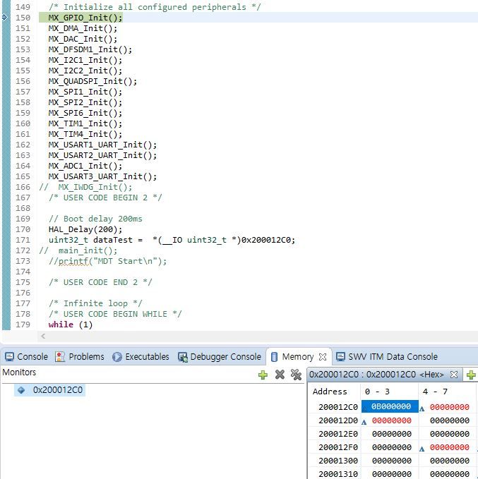

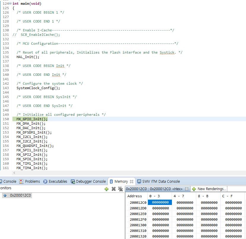

I use CubeIDE 1.3.0, STM32F769II.
When i debug variable value.
I found value having strange value.
It always happen when i click "reset chip".
Memory address is 0x20012C0.
when i start debug. It have 0 value.
But when i click "reset chip". 0x20012C0 memory value is changed.
How can i fix it.
Please help me.
Thanks.

Some variables get initialized during boot. This address could be within one of them. Why do you think it's a problem or that it should be 0?
waclawek.jan
Place a data breakpoint on that address, or single-step from the reset vector.
Review .MAP file, check stack settings.
Walk the Reset_Handler code.
Could also be debugger related.

I set break point this address.
Reset_Handler change value sometimes.
But i allocate 0x20012C0 address into .data sector (Initialized global variable) not .bss .
finally 0x20012C0 address value should be set to 0.
Because it initialized global variable.

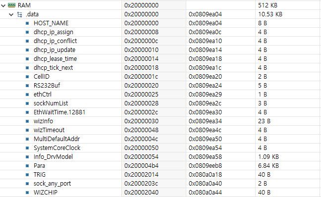

Usually you just define variables and let the linker sort out where to put them. That way there is a clear separation between .data and .bss. The default startup script relies on this to be the case.
How did you do this? What does your linker file look like?
hjuns
Thank you for your answer.
I define large size variable.
"Para" variable allocated 0x200004b4 ~ 0x20002014.
