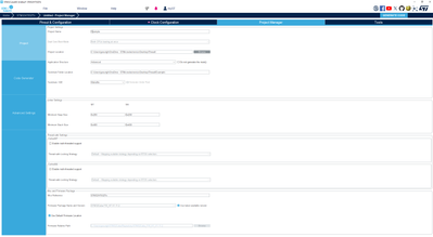

To generate a Makefile for an STM32 project using CubeMX, follow these steps:
Step 1: Open CubeMX and Configure Your Project
  1. Launch STM32CubeMX 6.13.0 (Link for download  STM32CubeMX - STM32Cube initialization code generator - STMicroelectronics )
  2. Configure your STM32 microcontroller settings, including clock configuration, peripherals, and middleware.
Step 2: Generate the Project
  1. Click on the "Project" tab.
  2. Set the "Toolchain / IDE" to "Makefile".
  3. Specify the project name and location.
  4. Click "Generate Code".
Step 3: Review the Generated Makefile
CubeMX will generate a Makefile in the project directory. This Makefile will include all necessary build rules, compiler flags, and linker scripts based on your CubeMX configuration.
THX
Ghofrane
