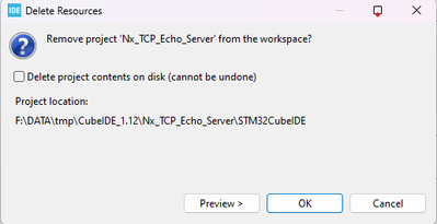

how to reproduce:
Create a new projet with a "namePrj" and "directory". The normal way should be to have a directory "directory"/"namePrj", and in this directory, all the project files (like with STM32CubeMX). But the files a created in the "directory".
If you what to change that, and try to erase the projet, it will erase ALL the content in the "namePrj" directory. Not only the project file, but ALL THE CONTENT!!!!

Lets say you have a directory:
C:/AllMyProject
When using STM32CubeMX, when creating a project, if you select "C:/AllMyProject" as the directory, and MyNewPrj as the name, il will create a new directory "C:/AllMyProject/MyNewPrj" that will contain all files. This is the normal behavior.
BUT
When using STM32CubeIDE (version 1.14.0):
  1. File--> New-->STM32 CMake Project
  2. Project from CMake template
  3. Project Name "MyOtherNewPrj", Location "C:/AllMyProject"
  4. Then select MCU and "Finish"
    1. Problem, all generated files will not be generated in "C:/AllMyProject/MyOtherNewPrj" like would MX, but directly at the root of "C:/AllMyProject/"
  5. As I do not want that because it is a mess and not logical at all (thank you ST Dev!), I "right-click" on "MyOtherNewPrj" in Project Explorer and "Delete with Delete content"
    1. It will completely delete "C:/AllMyProject/"
Deleting "CONTENT", is not deleting CONTAINER. Deleting a projet should delete... the project. No other file!!!

@ANauz.1 With all respect and sympathy, IMHO this was an important bit of experience with Eclipse and software in general. When you delete a project in Eclipse, it won't immediately nuke it! It will show a dialog like this:
A savvy user will think twice before checking in the "delete contents on disk' box... then leave it unchecked. Then  manually view & delete the files in explorer.  Reckless or curious folks will get what they deserve.
Also, talking about being professional - how about backups or version control for your valuable stuff? And er... manners?
Also, your scenario is not quite correct. With CubeIDE you create a CMake project. While CubeMX v. 6.10 (latest) cannot create CMake, it creates other types of projects (Eclipse, IAR etc. or plain makefile). These types of projects have different directory layouts.
/* EDIT */
Back to deleting a project: the preview dialog indeed is useless - it should list the items to be deleted. At least say "everything in that dir". The upstream eclipse should deal with this.

Who said I do not backup neither version control my work?
"Reckless or curious folks will get what they deserve". What they deserve is that "deleting project", should delete project. No other stuff. They could write "delete all in the directory containing the project"
