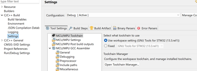

‎2025-05-28 4:40 AM
It's in the project settings (sorry about the image quality):

‎2025-05-28 8:11 AM
Did you find the project settings I showed? All you need then is to click the "Open Toolchain Manager..." button.

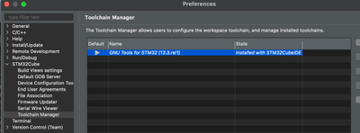

‎2025-05-28 8:43 AM - edited ‎2025-05-28 8:49 AM
Oh excuse me. I overlooked your post WRT Toolchain Manager. Found it.
Though I still don't know what to do now. Should I revert to a previous toolchain or upgrade to a newer one? In either case, how do I achieve this?
Momentarily it shows:

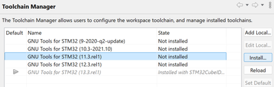

‎2025-05-29 7:27 AM
You should end up with something like this:
You can then select a different toolchain to use.
Which you use is up to you. If you're wanting to update software that is deployed, then I would probably use the version that was used to create the deployment - unless a full regression test set can used to ensure that changing the toolchain does not modify the code's behaviour.
‎2025-05-30 12:14 AM
Thank you. My problem was that I overlooked that a load process (fetching) in the bottom status area was going on taking a while. Now the area is filled with a couple of choices.
