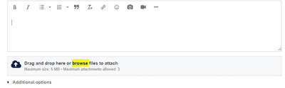

I made a zip file, but I don't know how to send.
What should I do?
I don't know much about PC.
October 19, 2023
Hello @MED2972,
You should click on browse and select the zip file.
Thanks.
