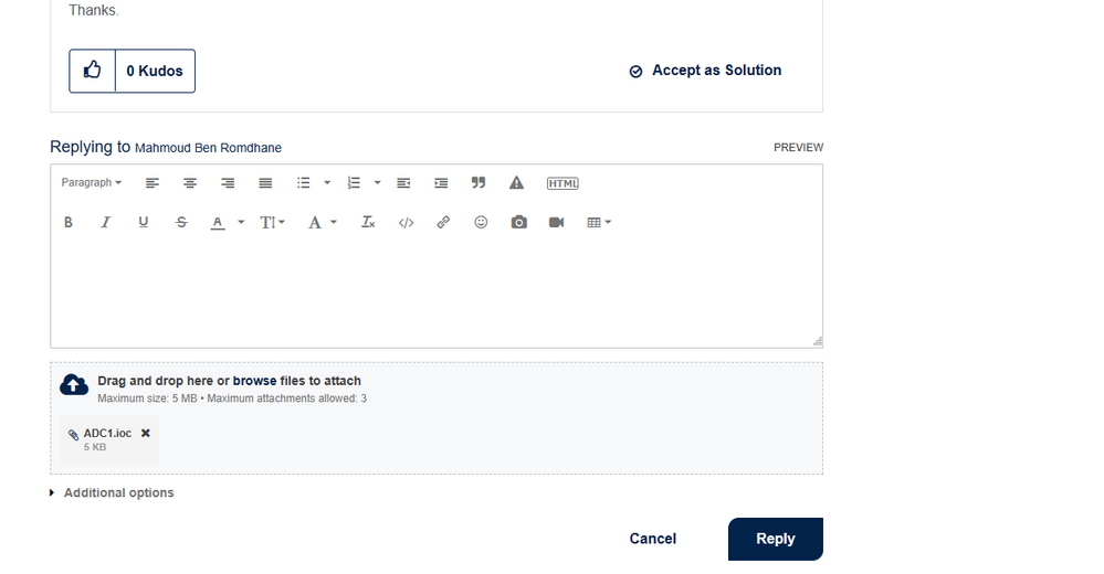

I tried to put the file .ioc, but this caution popped up.
Correct the highlighted errors and try again.
  • The attachment's adc1.ioc content type (application/octet-stream) does not match its file extension and has been removed.
