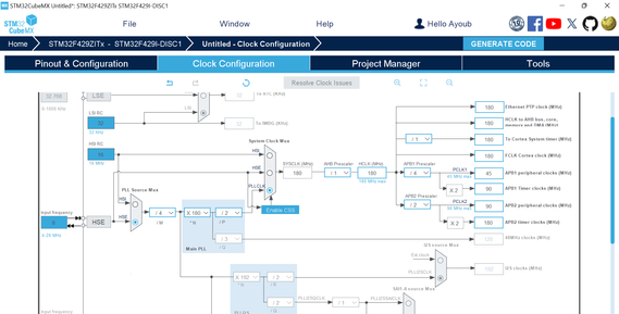

could somebody please help me with this: i am a beginner ,i have done the clock configuration and Timer configuration  for delay and also the GPIO configuration: the LED does blink but instead of 1s it takes like 4s , i have done a lot of research to find out where the problem might be, but found nothing i use STM32F429i discovery by the way . thank you and here is my code :

TIM1 / APB2 is likely not clocking at 180 MHz, but a fraction of that. So perhaps 90 or 45 MHz ? Check the divider settings and Clock Tree, in this context.
Also Toggling will further half the frequency (double the period) of a blinking LED
APB1 DIV4 is 45 MHz, TIMCLK= APB1*2, so 90 MHz
So 1000 delay is 2 seconds, LED ON at 4 second interval ?
i checked the Clock tree, the APB2 bus is working on 180 Mhz , and in the Timer configuration in PSC register i wrote 180-1, that means 180Mhz divided by 180 is 1Mhz which is 1 tick in on microsecond STM32CubeMX Untitled__ STM32F429ZITx STM32F429I-DISC1 07.06.2024 15_42_38.png
