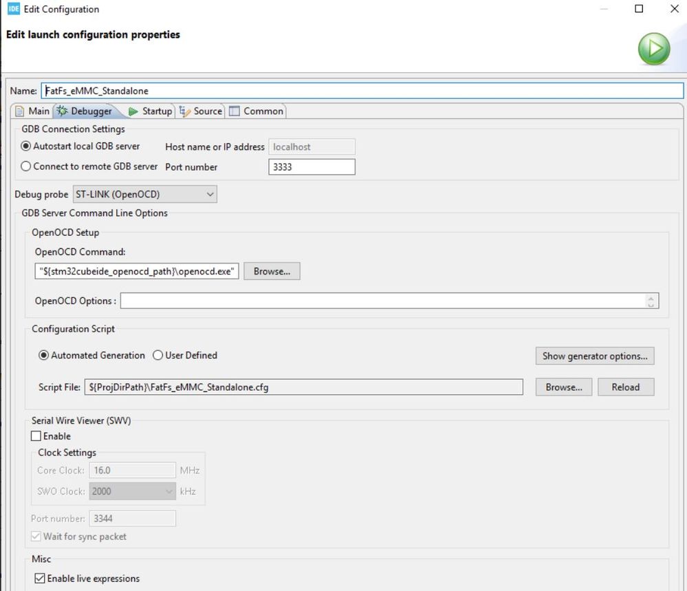

As workaround, I updated the Debug configuration in STM32CubeIDE as follow:
1- Use and configure ST-LINK (OpenOCD).
2- Add the command "monitor arm semihosting enable" into startup Initialization commands .

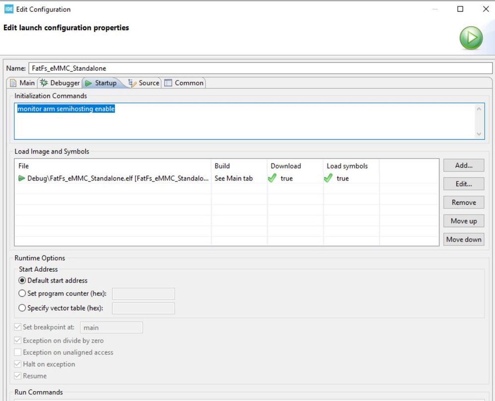

I hope this workaround is helpful for you.
