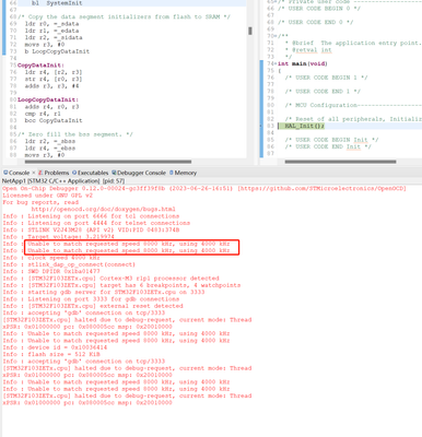

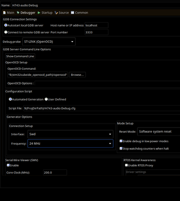

I am trying to debug an external application with an ST-Link coming together with my Nucleo-G070RB board. I tried all three available debugger probes in CubeIDE:  ST-Link (Open-OCD), ST-Link (ST-Link GDB Server), and Segger J-Link. they all failed.
The pins used for connecting the external application and ST-Link: VDD from target, GND, SWDIO, SWDCLK, Reset
The console messages when setting the debugger probe to ST-Link (Open-OCD:(
At debug start:
after clicking on Step-Over:
Error: Fail reading CTRL/STAT register. Force reconnect
Warn : target STM32F103ZETx.cpu is not halted (gdb fileio)
Polling target STM32F103ZETx.cpu failed, trying to reexamine
Examination failed, GDB will be halted. Polling again in 100ms

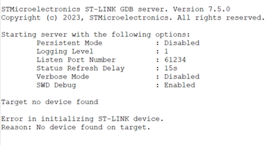

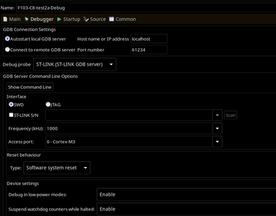

your first setup with ocd looks not bad, just try with lower speed + software reset , see:
Maybe your cables are long (> 20cm ? ) or you have EMI /spikes on ground, then always problems.
Try short (max. 20cm) wires, "good" ground (from same mains plug , no or small loops ).
Thank you for your reply!

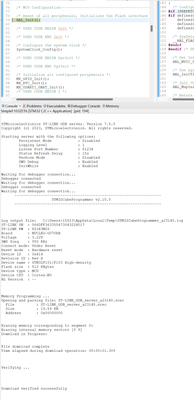

Applied your setup (Debug probe of ST-Link GDB Server, lower speed of 1000KHz and software reset), but still got the "target no device found" error. Same error for all reset options but Connect under reset.
Then changed reset option to Connect under reset, and got the following result:

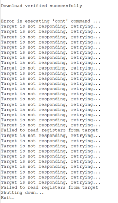

But when clicking on Step-Over the HAL_Init() function, error occurred:
The SWD connection cable is indeed long, about 70cm. But the flash download is OK, and the J-Link cable is even much longer (about 160cm), and the download has also completed successfully, all register readings are OK  before the Debugger halts the target. Therefore, I suppose that the debug failure was not caused by cable length or ground noise. The same J-Link has been used for debug on NXP Mcus (ARM Cortex M0+) for years before we switch to STM32 just days ago. The cable we are using with J-Link for production programming is more than 300cm, and it works well without any problems.

Found where the issue is:  by default, Cube chose "No Debug" for me, and I did not know there is such an option.
