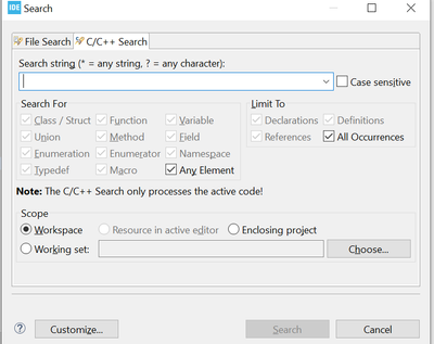

Hi ,
I am using the STM32 cube ide 1.12.0 version and the "search" CTRL+H was working earlier .Now this is not working .
I have used the shortcut key ALT+SHIFT+Q+S still not working ..
3 REPLIES 3
wfd
I have the same issue and I am using the latest version
NoviceStm32
Happened to me earlier as well. Try the following.
Try to reset the views by going to Window->Perspective->Reset Perspective. Then, Window-> Show view-> Search
Hope that helps.
Worked for me as well)
