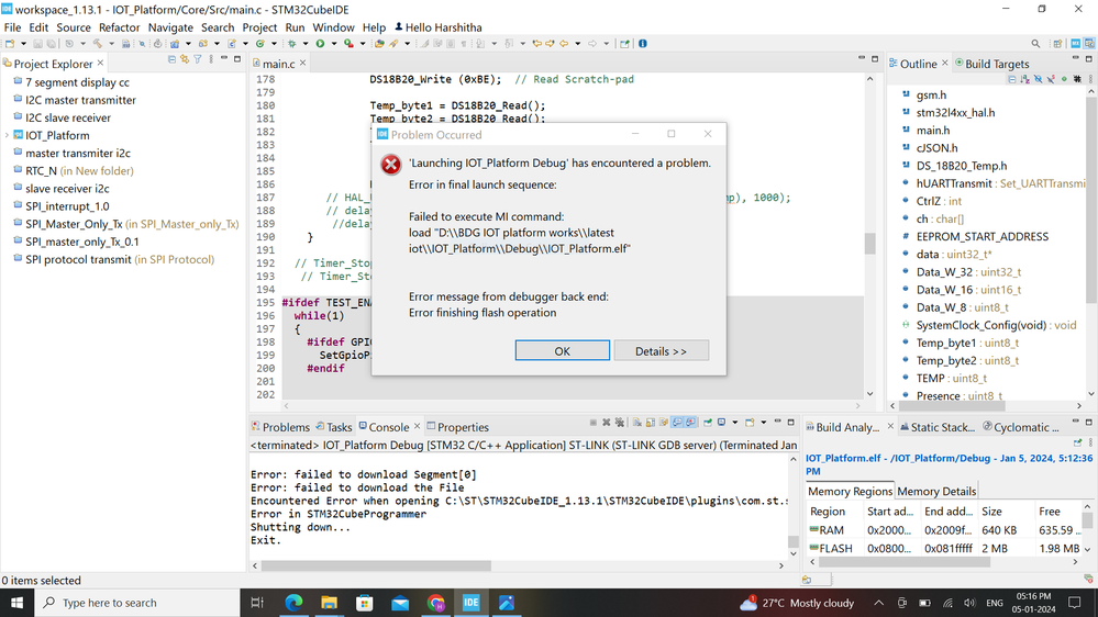

Hello stm community
While im trying to flash the code im getting this error
Error in final launch sequence:
Failed to execute MI command:
load "C:\\Users\\C\\Downloads\\RTC_N\\RTC_N\\New folder\\Debug\\RTC_N.elf"
Error message from debugger back end:
Error finishing flash operation

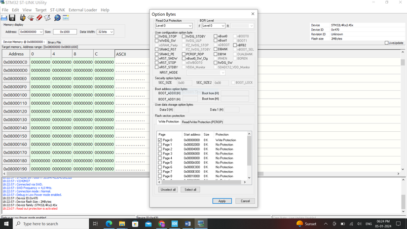

2.You have to install STM32 ST-Link Utility and erase with it the whole flash memory. After that, update the firmware on the board again.
i installed the ST-Link Utility and im trying to erase flash memory but im getting an Read out protection is activated message to resolve this i got an solution i need to change option byte configuration but i dont know the correct configuration for to change read out protection level 1 to read out protection level 0.
for the reference i attached the option byte configuration

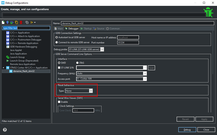

In my case, the WBA became unresponsive.  I could not use the STM32 IDE to program it with anything (was getting the errors you described above).  One forum said you could program with "reset behavior = NONE"... this did not work for me.  One forum said you could use ST-Link and clear the memory... ST-Link could not communicate with the WBA.  Another forum said you could use STM Cube Programmer... STM Cube Programmer could not communicate either.
Here's what I tried and seems to have fixed it.  In my debug configuration, I switched to useing the STLink Open OCD with a known good application.  That appeared to have failed.  When I switched back to STLink GDB Server (which is what I was originally using) and programmed with the known good application, then it worked.
